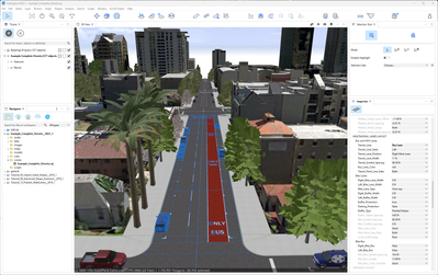

Hi
Please assist with the CGA code to build a road typology that has a parallel raillway line. It needs to look like the below cross section
Thank you.
SimonHaegler
Hi Ahmed,
one starting point could be the "multi modal lanes" rules in the "Complete Streets" example (see Help Menu -> Download Tutorials and Examples). The main tool to use is the UV split operation.
Hope this helps,
Simon
DevinLavigne
You'll want to make your Right "Sidewalk" wide enough to accommodate everything to the right of the road, including the Planting, Sidewalk, and Rail Line. And then you will need create a rule that divides that sidewalk accordingly, and creates the railway line.
