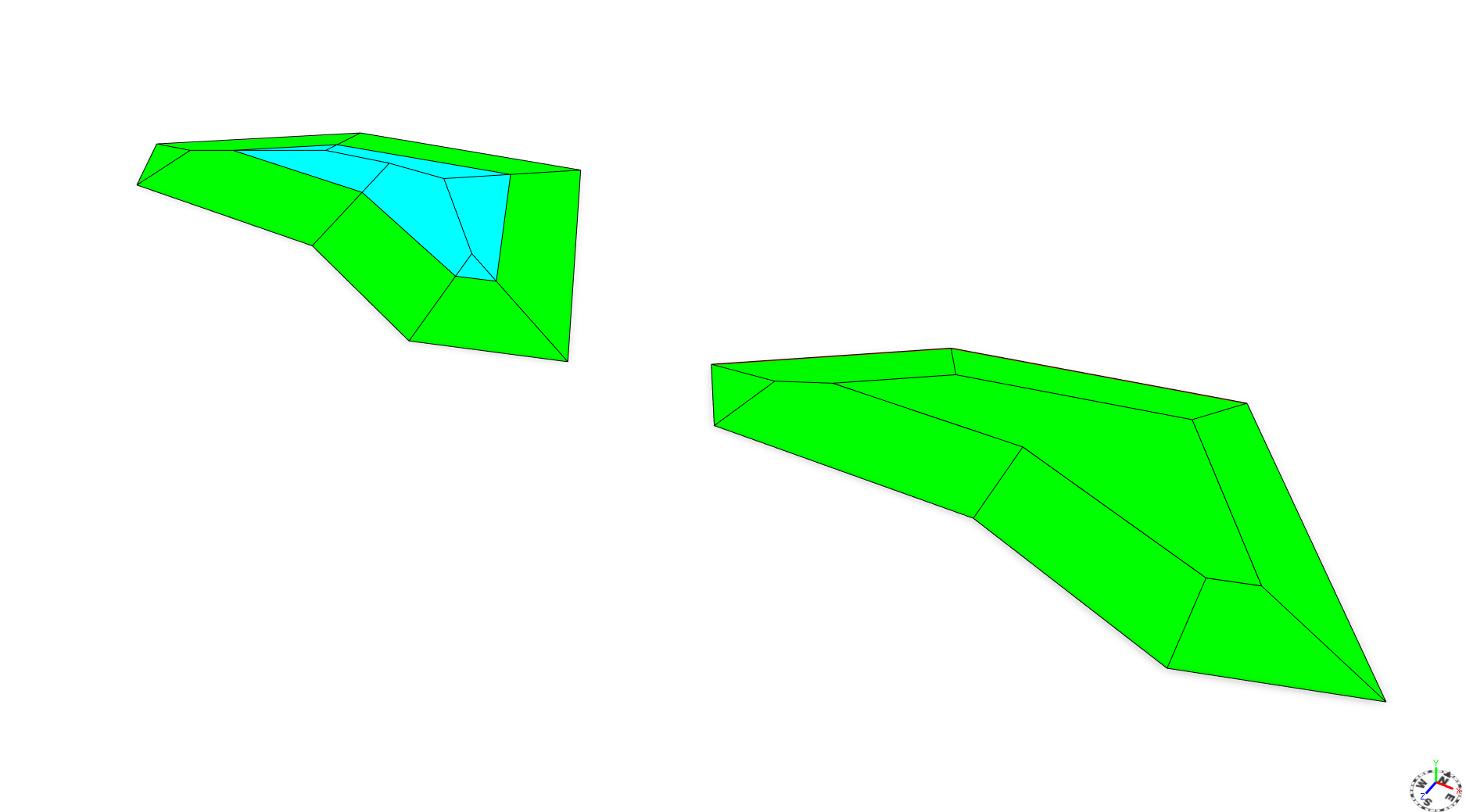

Any way I could merge and align faces parallel to the initial shape with CGA?
2482
07-25-2016 03:01 AM
LR
I'm constructing a pile of dirt that changes shape depending on a couple of variables. It starts out pointy and then flattens out. Using the roofHip operation seems to work for this however I'm stuck with the flattening out part. I comp'd the roof in X direction but I can't flatten it out. It should look like the pile on the right. Any ideas?
LR
Well, that's odd. I did try this approach, except that I split the components first and used the top. As you can see in the blue pile, my NIL part is invisible (as I thought it should be, the documentation says it deletes the face).
Unfortunately I might need to build on the plateau, and when I close the hole in your approach so I have a face to use, the pile pops back in (red pile).
For now I (mostly) solved the problem by using setback(), extruding the "core", closing the hole in the setback ring, then creating a roof. The roof center is cut out by splitting the roof so its edges meet the core top, the correct values for this are conjured employing the dark arts of trigonometry. Unfortunately, this is not 1000000000% accurate, resulting in tiny gaps or (rarely) invisible faces.

Ah dang, I should stop breaking up everything into faces first. This works great, on uneven surfaces as well. Piles sitting on steep hills can also be evened out by aligning the scope to the Y axis.
Thanks!
