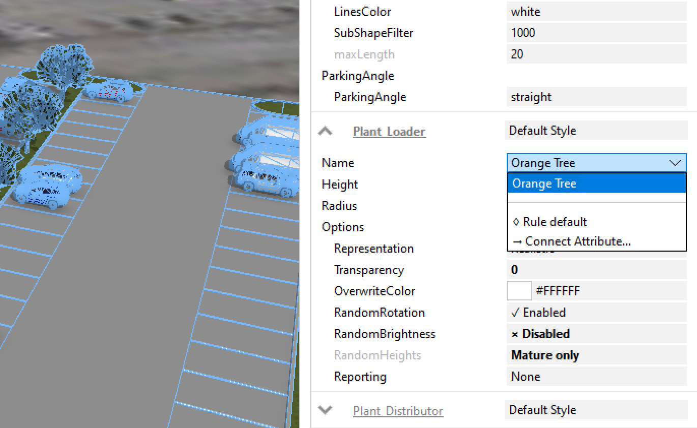

However,  some of the rules that I created using Plant.Loader.Generate now are slightly less flexible.  When I look at the Plant.Loader in the inspector tab, under the Plant.Loader selector attributes, I only see the current tree species and none of the other trees.   I figured out that if I parameterize the tree name when I call into my code:   e.g.  Plant.Loader.Generate("Red Hickory")  -  I can change it.   But I don't know ~100 tree species by memory so this is a little inconvenient when I am just trying to get the best "look".
Picture of what is happening in new Plant_Loader cga when called into my other codes (only Orange Tree, no others):
Also, I don't quite understand what is happening now, maybe there is some new documentation on this?

Sorry, this is a bug.  All the plant names should have been visible in the drop down box, but due to the bug, you don't see the other options.  We hope to fix this soon.
With regards to the unused attribute warning, this is expected behavior.  The code will still compile and run.  I understand that it doesn't seem right, but this is just how it is for now.
CherylLau
Thanks to your post, we have updated the Plant_Loader so that you can hopefully see the plant names in the drop down box again.  To get the new version (v125), go to File -> Manage ESRI.lib, select ESRI.lib, and click Update.
