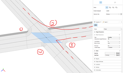

Currently, the curb radius parameter for street nodes is uniformly applied to all connecting segments.
Is it possible to set curb radii independently (at rule level or otherwise) for a node to achieve what I'm aiming for in the image below (where 1, 2, 3, 4 all have different curb radii)?

Indeed, this is a long asked feature probably already in esri's backlog. This would also allow direct use of double parallel street segments coming from OSM or other, when constructing complex median ways and intersections...

Thanks for this question/suggestion. Unfortunately, this is currently not possible. I moved the topic over to the Ideas board and we will update the status when have looked into it.

Thanks @JonasObertuefer - I also agree with @romainjanil that this feature will indeed open up many new possibilities for road/street medians and intersections - especially for city/OSM data (which is currently a pain to workaround) 😓

Thanks for providing this use case. The CityEngine team is considering to offer this functionality.
