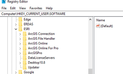

StaceyStark1
Thank you so much, Zemin. I recently upgraded to ArcGIS Pro 3.0, and that path does not exist in the registry editor.
I found a folder under my Business Analyst folder for the custom templates, but they are in a different format, and the .bprt is not recognized if I put it here.
 I am able to use the business analyst dataset in Pro because I specified it in Options - Business Analyst options (add dataset).  Is there more to the installation of Business Analsyt for Pro?
Thanks again.
StaceyStark1
I created the key folder structure that didn't exist in the registry editor and did find that this worked. Thank you!
