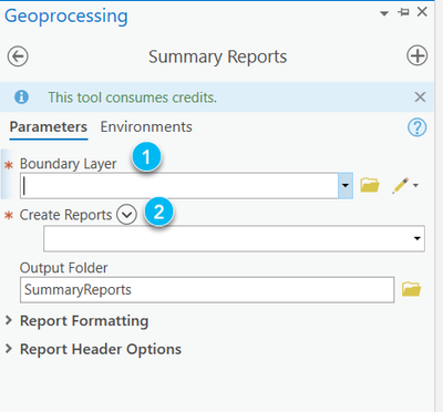

  • You can run report against the edited polygon in ArcGIS Pro using Summary Report (Business Analyst) geoprocessing tool
  • Choose your boundary layer (edited polygon) and select the report you want to run
  • Note: Requires a ArcGIS Pro Business Analyst extension license

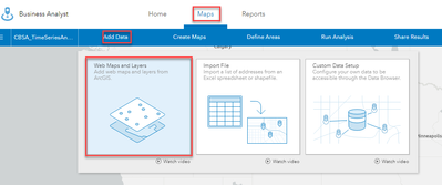

  • If you have already published the edited polygon back to ArcGIS Online, then you can use the following option to bring the layer into your Business Analyst Project
  • Select the layer > Add Selected

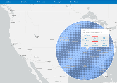

  • Click on the polygon once added and Choose Reports

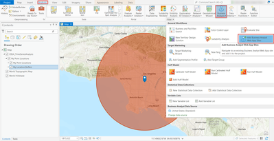

I also wanted to share that you can now Add Business Analyst Web App Sites directly into ArcGIS Pro
The sites can then be edited using ArcGIS Pro's editing tools and the changes will be reflected in Business Analyst Web App also. You can then decide to run reports in ArcGIS Pro or Business Analyst Web App. Note: this also requires a ArcGIS Pro Business Analyst extension license.
