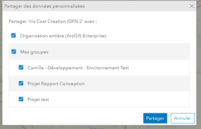

the sharing is correctly activated :
 and the feature layer concerned is sharing with my organization too.
If i can't myself see data when i try the infographic in the BAO app, i think the issue is not caused by the sharing of items.

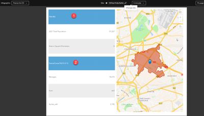

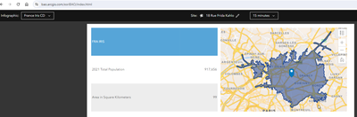

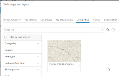

I found this sample layer in France and tried to reproduce the issue you mentioned.
I created the custom data > added the variables to my infographics > the results show the expected values for a drive time area.
I also testing with two different data sources (custom data) and confirmed the infographic works fine.

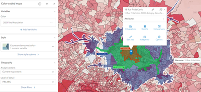

2. Make sure the drive time (or any site) you create and use to run infographics intersects your custom data. For example, just use your custom data to create a color-coded map and make sure it works fine and then the area coverage overlaps your site.

For your second point, i don't think it's the problem because i try to test my infographic IN business analyst map by adding my layers and selecting 3-4 polygons and it doesn't work in this step.
So, if it doesn't work in the BAO map by selecting polygons, it seems to be clear that is not the drive time area the problem.
