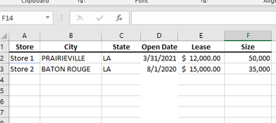

Let's assume your sample excel file looks like this and you want to include these variables in your custom infographics.

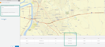

1. Go to Add Data > Import File > Import your file > select  Geographic boundaries
2. Match the input fields with the desired geography. For example, I selected "Place" to match the "City" field in my imported table as you can see below. Also notice that my date fields are preserved.
3. Save the sites and it will be added to your project here:

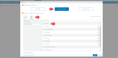

3. Then when you build your infographics, you can use the Site Attributes option and select the attributes from the imported site layer
4. Please note that you can only run the infographics on your imported features to get the date and string attributes.

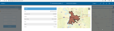

5. Click on the imported sites on the map and run the infographics you created with your variables and you will get the results as follows:

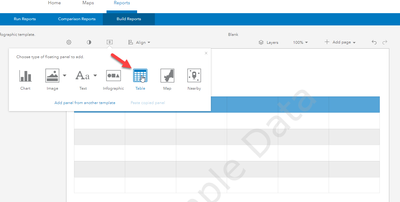

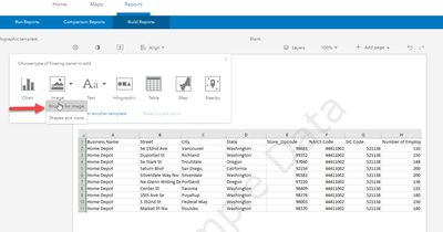

As you noticed, a location information is required when importing an excel file. However, if you simply need to add a static table from your excel table, I recommend using one of these options:
1. Add an image of the excel table to infographics:
2. Create a blank table and manually populate the values by copying from your excel table:
I hope this helps.
