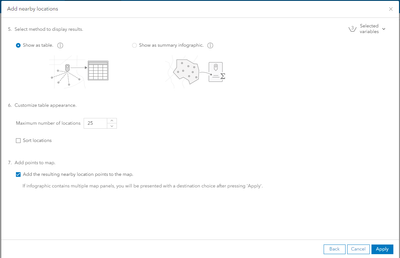

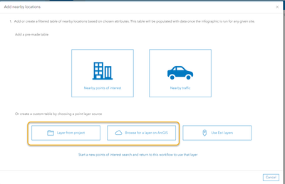

Hi @JasonBOCQUET Thank you for reaching out with your question. One option to consider for this goal is to build an infographic using a Nearby panel that is based on your custom layer of buildings.
With Nearby panels, you have the ability to configure the appearance as needed and display the data as a table or as a summary. Here is a quick example.
1. When configuring the Nearby panel, select your layer using one of these options:

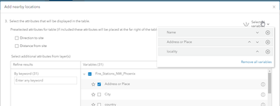

2. Then you can select the fields from your data to include in the table:

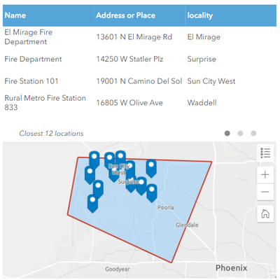

3. You can add the table and link it to a map:
4. Then Run the infographic using a site in the area of interest:
