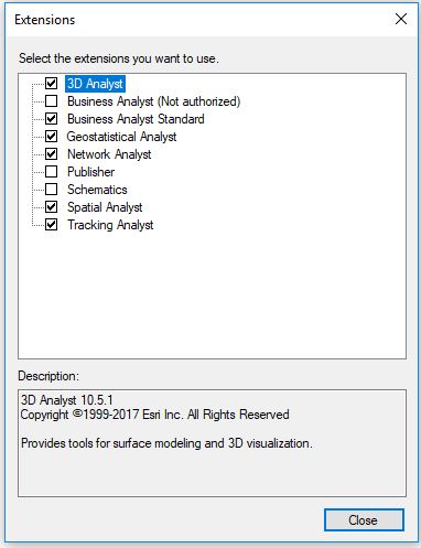

On the extensions panel, I have two Business Analyst option, but only able to check one, another one is Not authorized.

As far as seeing 2 options available for extensions, there are only 2 license types for Business Analyst, Basic and Standard. It appears that you are licensed for Business Analyst standard and not basic and that is why you see the second Business Analyst checkbox selected.
