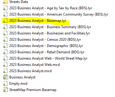

Completed the 2024 BA data download. I do not see the "Business Analyst - Basemap.lyr"
1650
8
07-15-2024 05:49 AM
georgedaigh6
Hi,
Over the weekend I completed the 2024 BA data download. I am not seeing the layer files that came with the 2023 data, in particular the "Business Analyst - Basemap.lyr" that I use daily. Below is a screenshot for reference? Perhaps I missed a step or did Esri do away with these layer files?
Thanks - George
