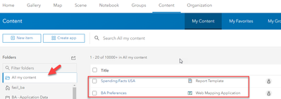

Actually, you will need to this on your end. Sign in to ArcGIS Online, and under My Content, delete the following items: SpendingFacts USA, BAPreferences.  You will lose your saved preferences (if any), but this reset often resoloves the issue you're experiencing. After that, try BA Mobile again, restart the app if necessary. Please let me know if this works!
