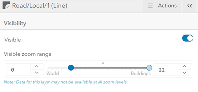

1.  The inability to set the zoom level for detailed roads.  It locks the visibility at 5 with the message that this layer is not available at all zoom levels. We typically map at market level and the ability to have detailed roads visible in addition to set the visibility for other features such as cities is needed.

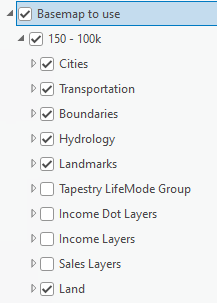

2.  I don't see a way to place my demographics layers within the layers of the included basemap. The drawing order of my current basemap is as follows.  The StreetMap Premium Basemap does not have the layers broken out nor did I see a way to edit that particular map in VTSE.

I have included a few sample maps to illustrate the above concerns. In the meantime I will continue to use the 2023 compatibility pack in order to keep using our branded basemap but I was wondering what the solution will be moving forward.  Thank you.
