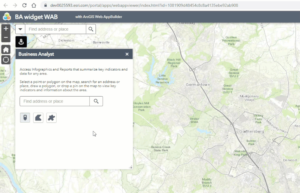

When using the business analyst widget in web appbuilder, the point/drop pin does not respond when clicking on map. Also unable to select point features to trigger infographic/report selection in widget. Only way to drop a point is to search an address.

I checked the BA widget in WAB using the ArcGIS Online and also recent portal version version and confirmed the pin drop is working as you can see below:
I suspect your portal might not be configured properly with a geocoding or geoenrichment service. When you drop a pin or select a point feature, the app does a reverse geocoding to determine the country. So I recommend looking into why that is failing in you portal. If you have a custom geocoding service, make sure it allows reverse geocoding.

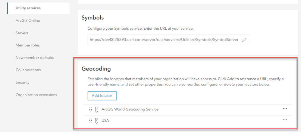

For reference, here is my portal Utility service configuration for geocoding.
Also check you GeoEnrichment utility configuration on this page. I hope this helps.

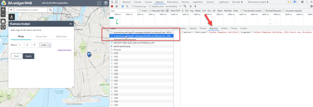

Please inform your system architect that when you drop a pin or select a point feature from the map, there is a reverse geocoding request that is most likely failing for you. If you open the developer tools in your browser, you should be able to see the request and see if there are any errors in the response.
If your system architect is unable to troubleshoot this for you, my recommendation is to gather all the version information of your portal and BA Server or BA Enterprise and contact our technical support team
