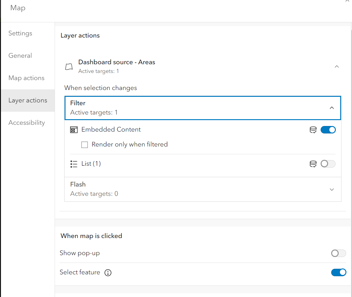

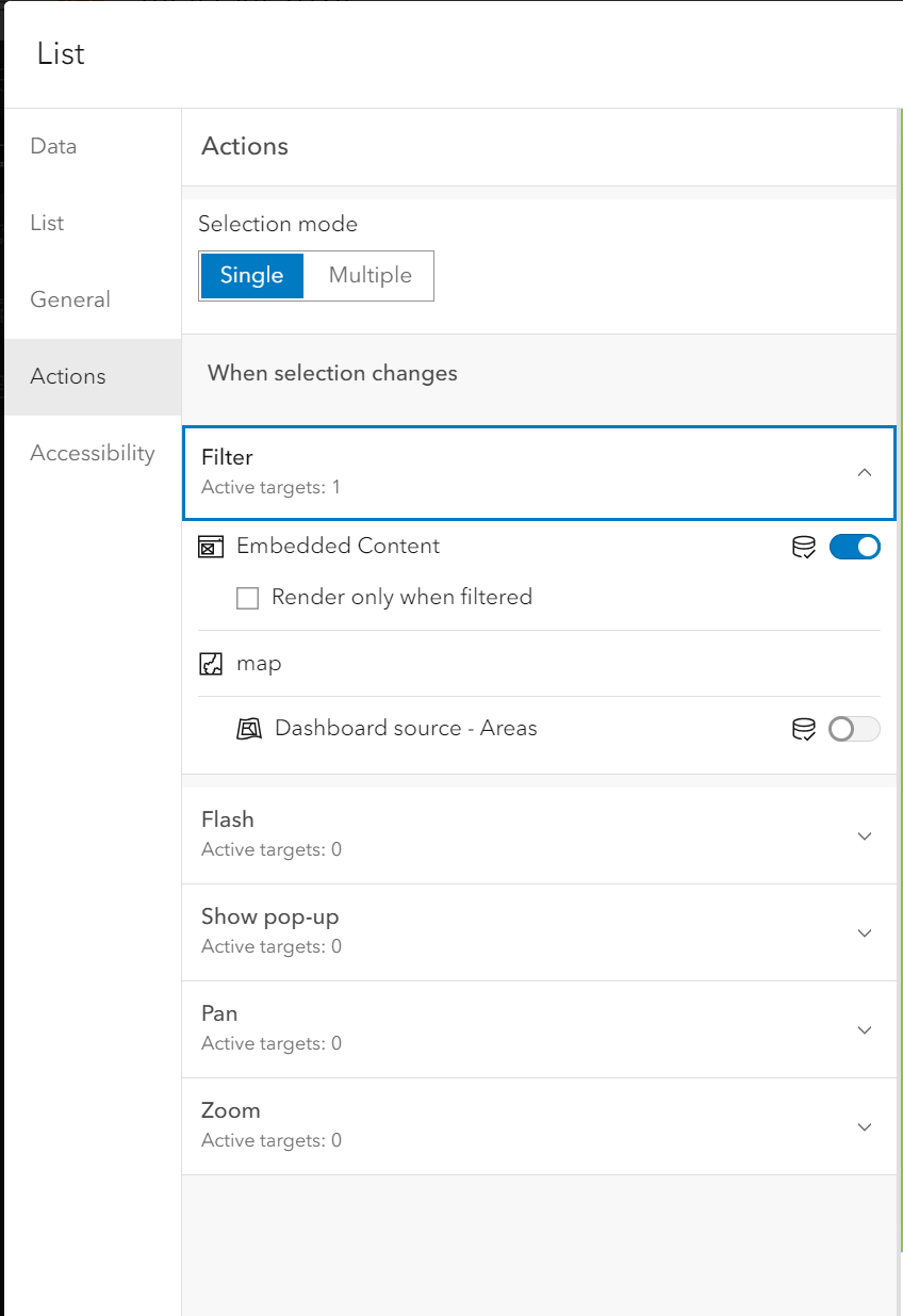

I have created a dashboard through business analyst, by sharing sites for an infographic. The dashboard that was generated has a dashboard, a map, and a list, and I am trying to configure it so that a user could click on a site name on the list OR on the map, and both methods would generate the infographic for that site.
However, it seems I can only have one method work at a time, and when I try to configure the second method, it renders the first method unusable, showing a "no data" message where the infographic should be. I first configured the map, and it worked, and then configured the list, but now only the list generates the infographic and nothing happens when I click on a site from the map.
Here are the configurations I have, please let me know if I should change anything so that both the list and map connect to the infographic. Thanks!

I was able to get both the map and list actions update the infographic (embedded content) by configuring the map settings as follows:
However, the list will also get filtered this way and you will have to clear the map selection to get the full list back.
