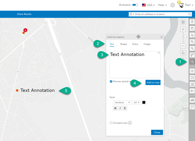

If you don't have many business points on the map, the simplest way to add labels is using annotations. However, these annotations are temporary and will be removed if you reload the app/browser. We are currently working on a better solution for the future so you can save these annotations layers.

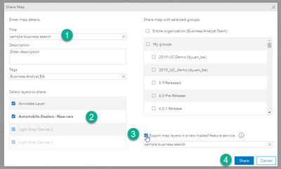

1. Click Share Results > ArcGIS Web Map
2. Add a title and check the Export map layers in a new hosted feature service check box.
3. Click Share

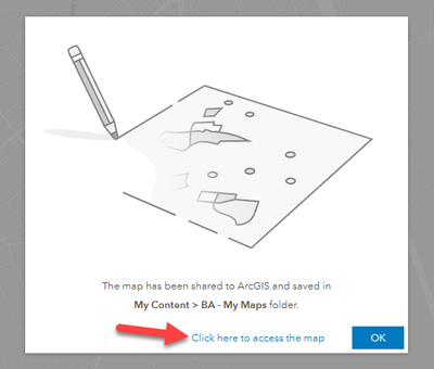

4. When the process completes, click on the link to the web map.

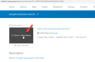

5. Click on Open in Map Viewer

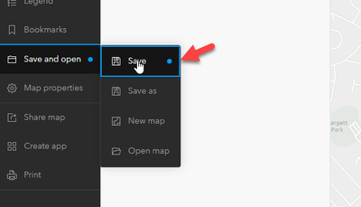

6. Open the label option and click on + Add label class
7. Click Save the web map.

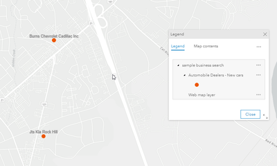

8. Your business are labelled and you can continue to use them in the ArcGIS Map viewer or add the web map back to Business Analyst web app to see the labelled features.

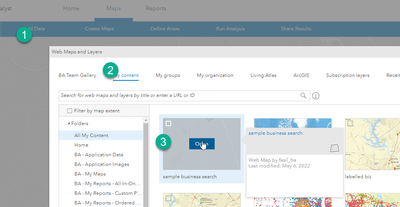

You can do that by going to Add Data > Web Maps and Layers > My Content > sort by recent and add the web map you already labelled in ArcGIS Online.
You get the labelled business points on your map now.
