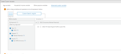

I'd like to calculate a custom variable for a table in my infographic.

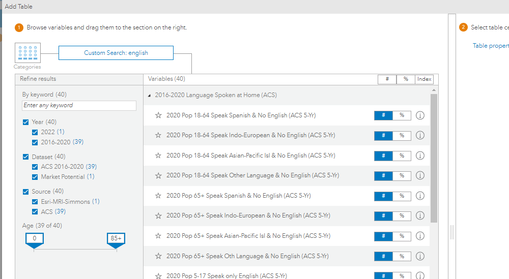

In the standard variable search when I search English I'm able to see the ACS language spoken at home variables.

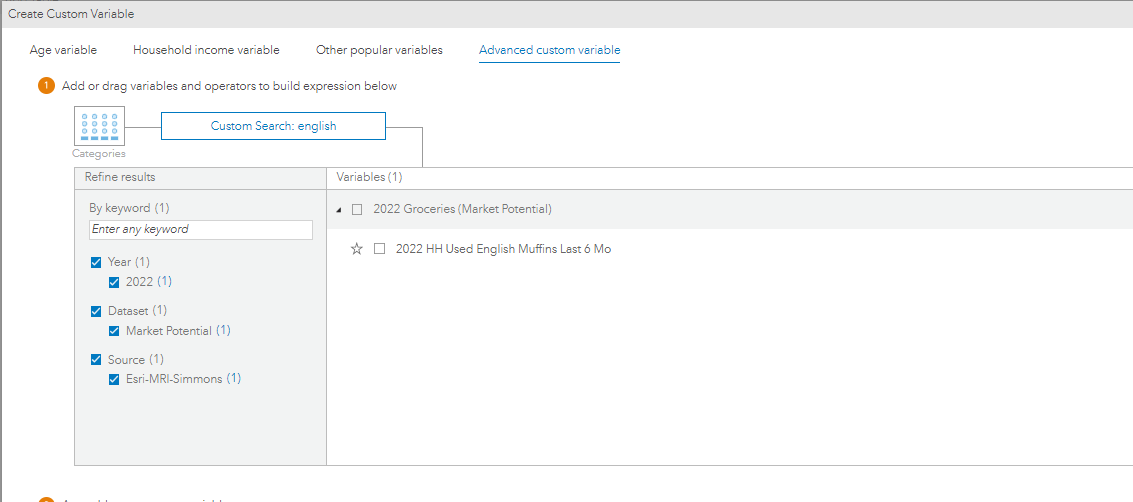

When I go to create a custom variable and search English the ACS data doesn't show up. Is this expected?
CherylHagevik
Hi @ArielLow2146, thank you for reaching out with this question. Some variables, including ACS data for all 50 states and the District of Columbia, are not available for creating custom variables. This is as designed to help ensure the quality of calculated variables.

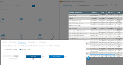

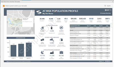

Hi @CherylHagevik. Thanks for that information! What is confusing to me is I'm able to see custom variables with ACS data when adding panels from some of the templates available. If the variables are not available to help ensure quality why are they used in calculations in the templates?
For example, when I add a panel from another template, choose the At Risk Population Profile, and then add the Language spoken table.
Then when I go to edit the table and select the bottom most row in the Total column it appears to be a custom variable with ACS data.
CherylHagevik
Thank you for explaining your additional question @ArielLow2146. In this situation with the At Risk Population infographic template, the simple variable calculation you are seeing is accomplished through the settings within the table itself. The cells in the row are summed to the column labeled Total. When designing tables for infographics, you can select multiple cells using the shift key and then use the Caclulate totals tab to add a row or column summing or averaging the selected variable values.
I hope this explanation helps and please feel free to let me know if you have questions about any of the other Standard templates for infographics.
