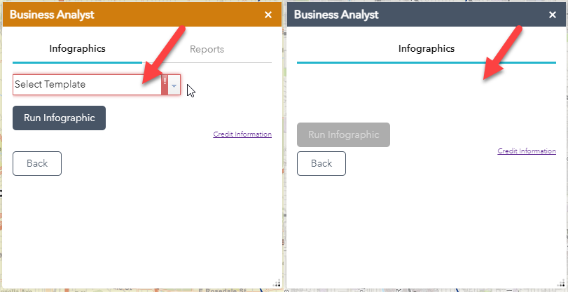

It is very important that go through the following migration and update workflow if you have created any custom infographics or reports. If you use shared infographics or reports, the owner of those templates should do the same. This action is required even if your templates contain your own data and no Esri data. If the migration and update is not complete, you will not see your custom infographics and reports listed under My/Shared Infographics/Reports.
If your app is previously configured with a default custom infographic or report, you might notice the missing template from the list.

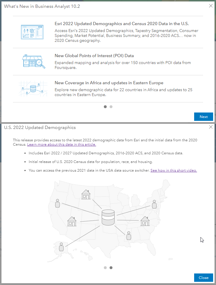

2. First you will see these welcome messages explaining what's new in this release. Please take a moment to read through these notes.

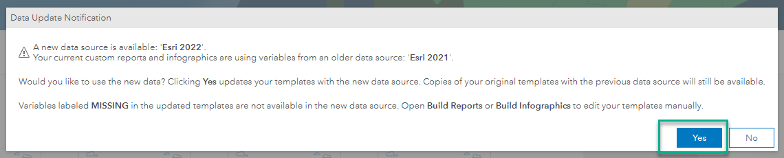

3. Then you will be prompted with this data update notification. Click Yes here.
Clicking Yes creates copies of your reports and infographics in the new data source, Esri 2022, and updates the variables. Your original reports and infographics are still available in the Esri 2021 data source.

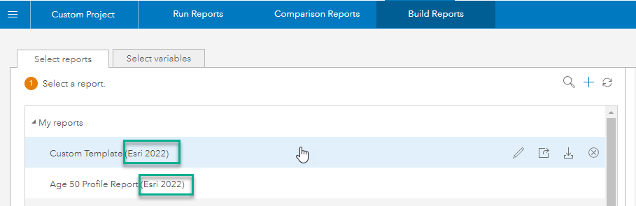

8. If you go to the Build Reports or Build Infographics workflows, you will see your templates are now migrated and contain (Esri 2022) in the names.

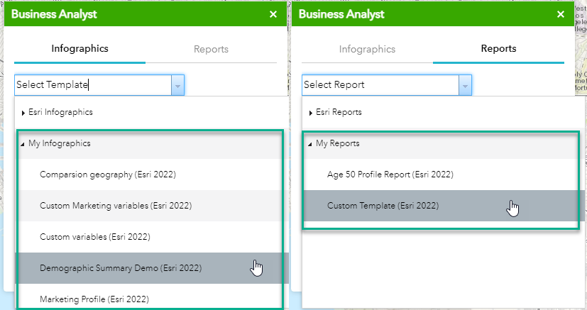

9. You can now go back to your Web AppBuilder app and simply refresh it to see your updated infographics and reports. You can also edit your widget and set the default template at this point.

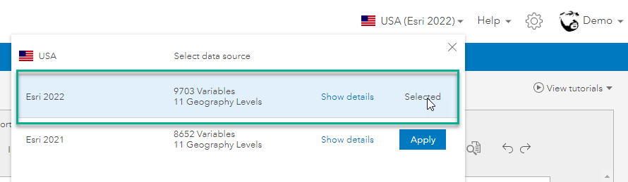

10. Going forward, just make sure to select the Esri 2022 data source before creating custom infographics and reports so that your templates are automatically available in the Business Analyst Widget for Web AppBuilder.
