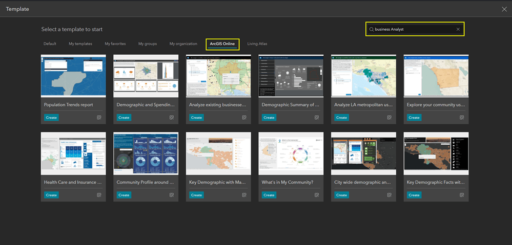

  1. Open ArcGIS Experience Builder from your ArcGIS Online organization.
  2. Click + Create new.
  3. On the Select a template to start page, click the ArcGIS Online tab.
  4. In the search field, type Business Analyst or Community Analyst.
Template search
There you have it – all the curated templates, ready to be used and customized.

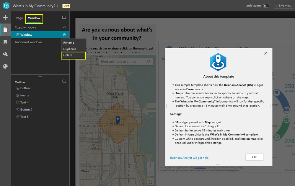

As an example, if you wanted to create your own “What’s in My Community” web experience, you can click Create on that template, and you will be taken to the builder. From there, you can leave everything as is or make any changes you want.
I suggest at least removing the window that pops up with the template information. Before you do, note the valuable information included. You can remove the window by going to the Window tab in the Page pane and choosing Delete from the Window options menu.
Delete window

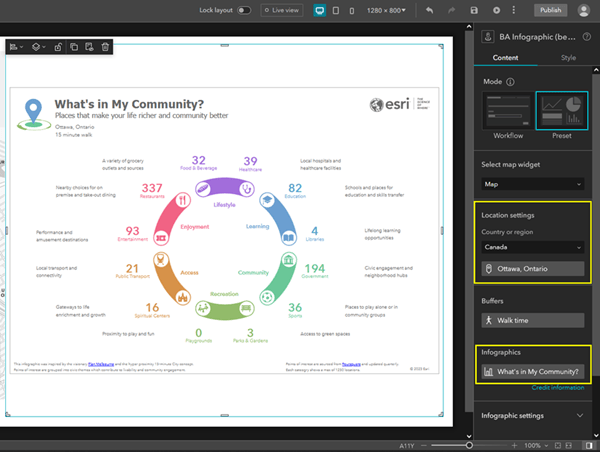

Now, maybe like me, you live in Canada and want to use this application for finding what’s within a 15-minute walk time in your Canadian community. Since the What’s in My Community infographic is also available in Canada, you can change the Business Analyst widget’s location and infographics settings to reflect this.
  1. Select the Business Analyst widget to open its configuration options.
  2. In the Location settings section, choose Canada from the Country or region drop-down menu.
  3. Optionally, you can choose a default location for the infographic.
  4. In the Infographics section, choose What’s in My Community.
Business Analyst widget configuration
Now this same template is set up to be a web experience tailored for Canadian communities. Note that not every infographic is available for every country.
