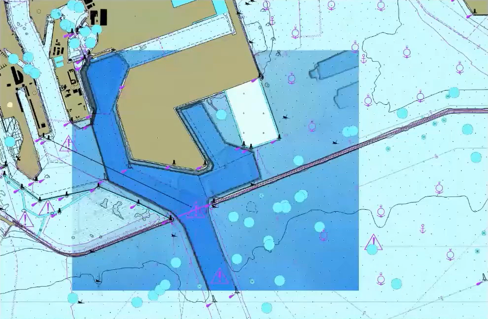

S-102 layer added to a nautical chartS-102 layer added to a nautical chart
Initial support is available with two new tools that are provided in the product data files. These two tools, Export To S-102 and Add S-102 Fields, are part of the S-102 toolbox. While the toolbox does not appear in ArcGIS Pro automatically, once it is added, the toolbox and its tools will appear in the Geoprocessing pane for easy access, much like ArcGIS Pro’s standardly available tools.
