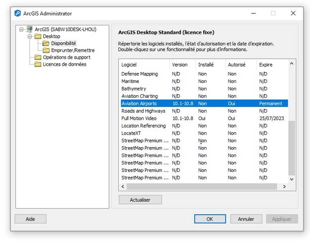

In fact, I encountered an error while using Arcgis Desktop. I purchased a permanent licence of Arcgis desktop and a permanent licence of avaition airport extension. But when I try to enable aviation airport extension in Arcmap it doesn't show in drop down list though its permanently activated.
Any help from users that have a certain experience in using this software will be appreciated.

It looks like you do not have Mapping and Charting Solutions Aviation installed.  It is a separate install from ArcGIS Desktop (ArcMap).   You can log in to your My Esri Account and find the install file under your 'Downloads' area.  https://www.esri.com/en-us/my-esri-login

    It is recommended to use Pro 3.1 instead of ArcMap.   The Aviation Airports extension is more advanced than the ArcMap version and it has all the advantages of using ArcGIS Pro.  ArcGIS Pro Aviation Airports is not a separate install since it gets installed and updated within Pro.   Beyond that, ArcMap will be retired in a few years and users are migrating to Pro and new users are discouraged from starting with ArcMap instead of Pro.
