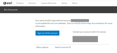

I tried to go to My Esri page with my organization account and it shows like this

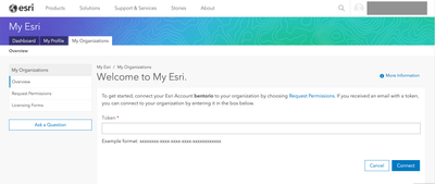

And I've already link this account (bentorio) to my organization account but i didn't see download tab.
What should I do?
DavidWickliffe
If signed into My Esri, there is a Common Questions section that you can search on how to download.. https://my.esri.com/#/questions/
I think if you do not see a Downloads tab under your 'My Organizations' then you have to request permission.   Under that same place there is a topic on 'Permissions', too.  You may also see a 'My Esri Help' sideways button along the right margin.  If you click that, there will be a 'Contact Us' link where you can email the My Esri support.    There is also a Community page for My Esri questions:
https://community.esri.com/t5/my-esri/ct-p/my-esri
Hopefully, you will be able to access and download software soon!
