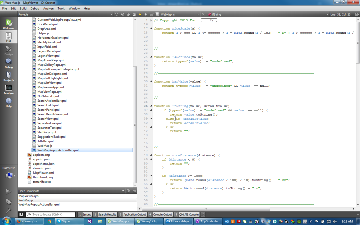

DavidStajan
I don't have such a file in the project.  There's a webmap.js file but no webmap.qml. Are we talking about the same code base?  I'm referring to this mapviewer https://www.arcgis.com/home/item.html?id=0faea839dea644e688da36bccae87aa8
