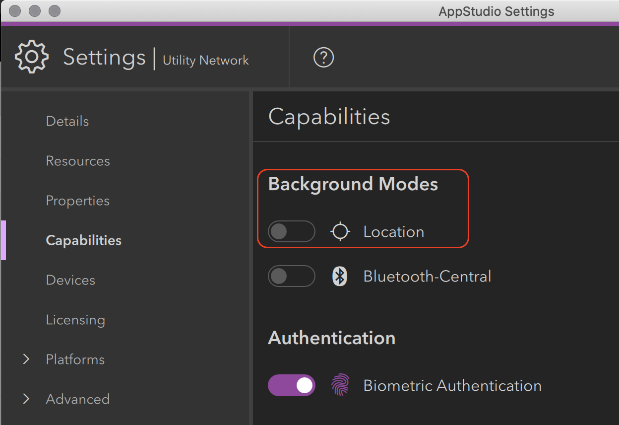

I think this can be achieved by enabling the Background Location capabilities, Capabilities—AppStudio for ArcGIS | Documentation
This can be done by going to the setting of the app and enable the Capabilities > Background Mode > Location.
And then please make sure that to check the Qt.ApplicationState property, the app should be in the ApplicationHidden state in the background mode.
