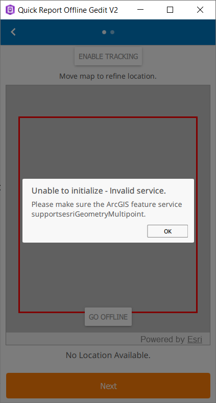

When I run the Quick Report application with feature service defined above I get the following error:
Any suggestions will be appreciated.

Yes we have made sure the parameters to the feature service and the layer ID are right:
The app is able to read the service:
Its when I click on the multipoint layer I get the error.
