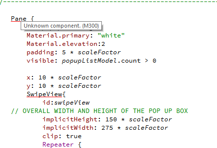

I am using the Template Quick Report 3.3
I am then referencing the WebMap Template
I am trying to add the "WebMapIdentify.qml" code into the Quick Report.
I pointed to a new webmap and can see my data in the QuickReport Location page.
I want to identify on those features.
When I add the Pane and SwipeView code to the "RefineLocationPage.qml" I get an error that says Pane and SwipView is not a type.
I have looked everywhere for a reference to this or some sort of configuration etc.  I am new at this so please bear with me.  Is there somewhere that I need to define or import something that recognizes those?

Those controls are imported at the top of the RefineLocationPage.qml file as:
import QtQuick.Controls 2.1 as NewControls
In order to use them you can reference them as NewControls.Pane and NewControls.SwipeView.

Awesome...I knew I was just missing a reference or something.....Cheers
