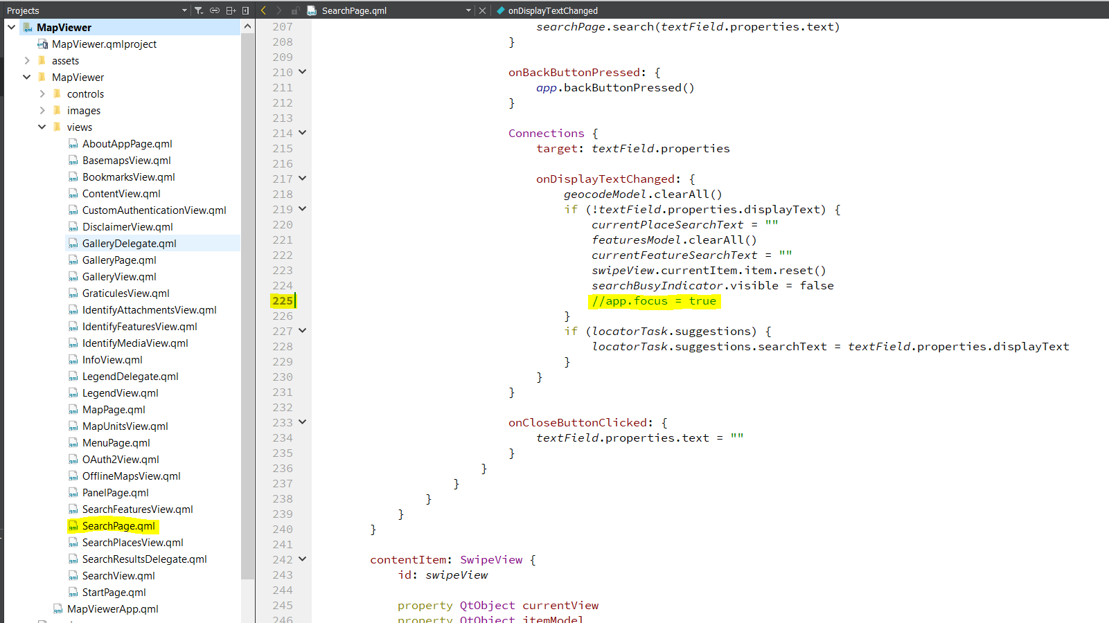

The line 225 of widget SearchPage.qml has a instruction that change the focus of application when the text property is changed on search box. When I click on my search box, the text was cleared firing this event that cause a focus changing from search box to the application, preventing showing up keyboard for entering with searched term. This occurs only on iOS platform, and was solved comment this line.
SOLUTION
On SearchPage.qml widget you need to comment line with app.focus = true command, that change the focus from a search box to application.

Thank you for sharing this issue and the solution, we currently have this bug logged for this specific issue,
[BUG-000112379 - Apps created using the Map Viewer template in AppStudio for Desktop fails to display the on-screen keyboard when searching (iOS only)]
