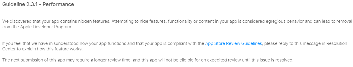

So my app based on Survey 123 template and published with App Studio was rejected in App Store for hidden content. Please see the screenshots below (btw I successfully published it to Google Pay):
This is form Resolution Center:

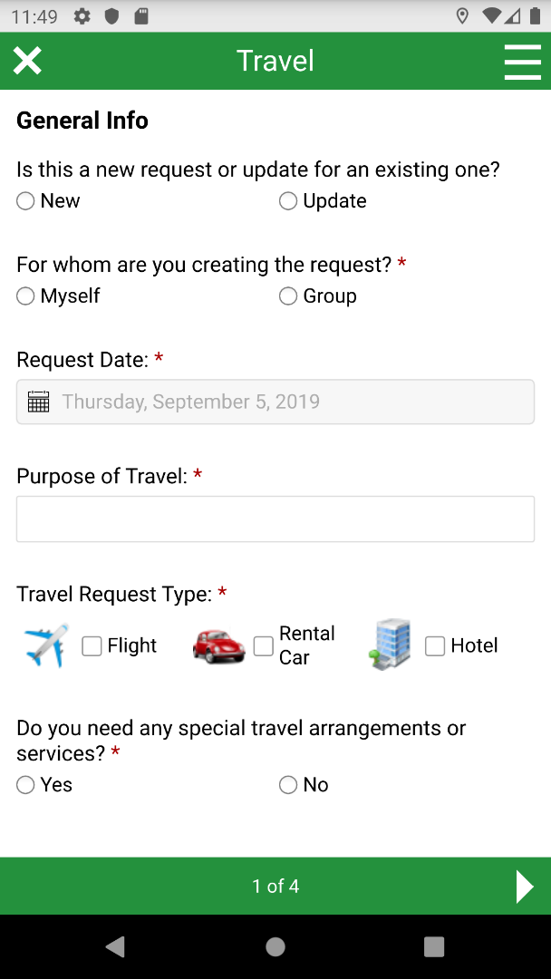

I don't know what they considered the hidden content, the form of course has a lot of dynamic content, and the questions appear depending on what the user entered previously, dynamic labeling is also present.

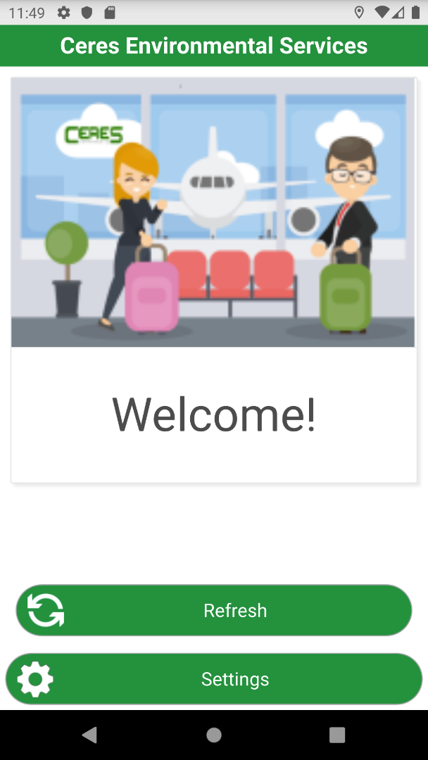

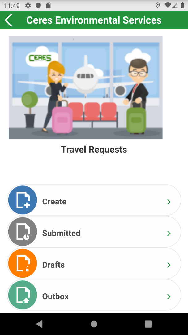

Can please somebody advise? According to the screenshots I published, what do you think can be considered hidden content by APP Store? All the app does is loading predetermined survey, I have settings and refresh buttons on the gallery page, than by clicking on the picture of the survey it opens survey page with folders, and then the same functionality that survey 123 has.
