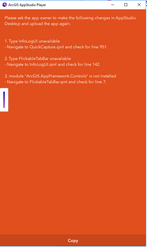

Hi, I'm trying to build a copy of the quickcapture template. The cloud build process runs fine but when the android app is opened we just get a white screen.
Running the app in Appstudio Player gives the following screen which suggests that the issue lies with the Arcgis.AppFramework.Controls module. The documentation has nothing on this module. Is it deprecated? Any workaround?

AppFramework.Controls has been deprecated for quite a bit and removed in AppStudio 5.0. https://doc.arcgis.com/en/appstudio/extend-apps/appframework.htm
We recommend replacing that UI control that you are using with Qt Quick Control, https://doc.qt.io/qt-5/qtquickcontrols-index.html

Removing the include for Arcgis.AppFramework.Controls from flickableTabBar.qml gets the app to work.
Unfortunately the ability to collect polylines does not work in the built app. Whey you try to collect a polyline the button flashes as expected but nothing gets recorded. Points do get collected although they don't get displayed on the map. I'm not sure why.
