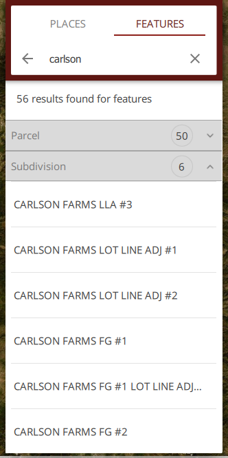

I'm working with the Map Viewer template and I want the results returned from the Feature Search (SearchPage.qml) to be sorted.
I have a web map with 8 layers with 3 layers that have searching enabled.  For example I have a layer of parcels that I search by Owner Name and a Subdivision layer that I search by Subdivision Name.  When the results are returned I would like to have the Parcel results sorted by Owner Name and the Subdivision results sorted by Subdivision Name.
As an example - when I search for Carlson (an owner name and a subdivision name) (or a floor cleaner and a dessert topping) I get the following unsorted results:
My users would really like the results to be sorted within each layer.  I've attempted to add orderByFields to the SearchPage.qml in the QueryParameters with mixed results.

ErwinSoekianto
Esri Alum
Dan,
I think this can be done if we sort the result of each layer on the client-side.
For example, on MapViewer/view/SearchPage.qml on the signal OnFeatureSearchCompleted, the featuresModel is sorted by "layerName" attribute. The modification would around this logic.
This is the function sortByStringAttribute on MapViewer/controls/CustomListModel.qml
I hope this is helpful,
Erwin
