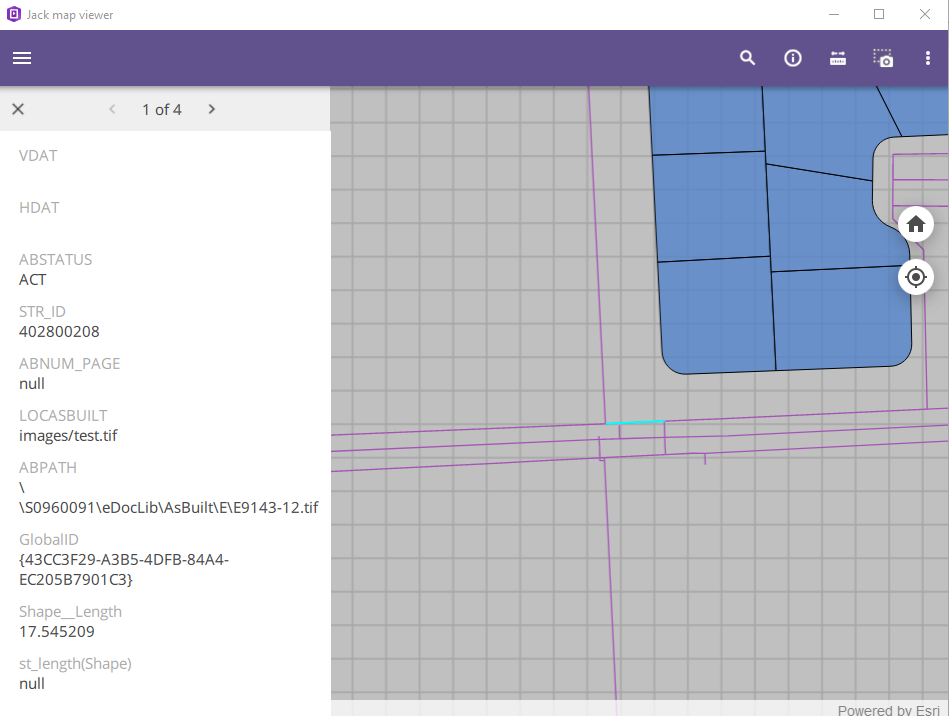

I am trying to roll out an offline MMPK with AppStudio for android using the Map viewer templet. I need to add a hyperlink that refers to the local file system in a images folder inside the viewer project or to the on-board SD card. Is this possible?

Thanks for your quick reply, I have already seen that link and it did help. I am now able to get the hyperlink to show but now a am getting Cannot display PDF (e77-1.tif is of invalid format). do you know it the Tif format is supported?
