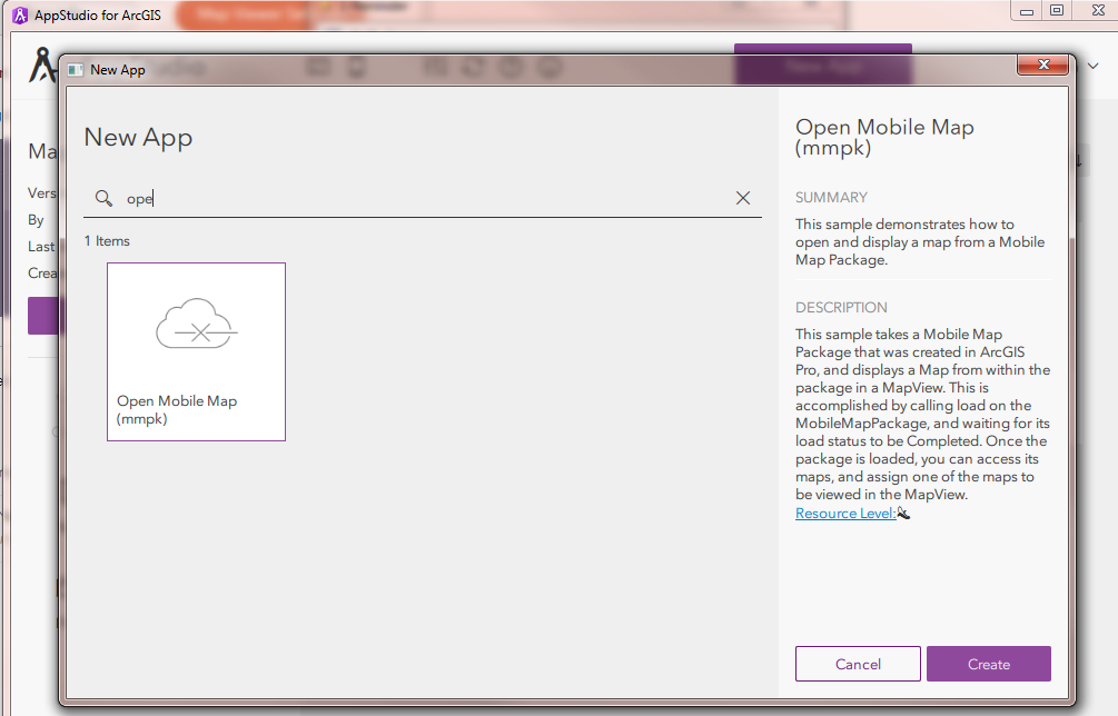

We have a sample which demonstrates that. Go to New App> Search for Open

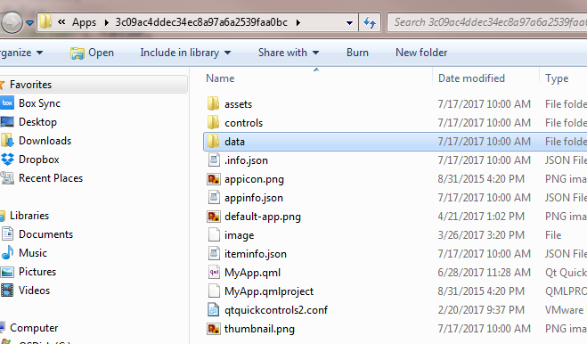

That known location is within the app not outside the app (see image below). To set up your project just drop the mmpk in the data folder of your app. And then follow the same code to copy the mmpk to the folder as used in the sample. The reason behind the copy is because when you include mmpk within your app you cannot use local relative path in your code since on devices like iOS and Android the apps have access to only virtual file system. So we will have to copy the mmpk internally once the app opens.
