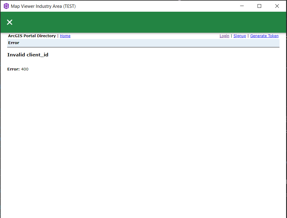

Hi guys,
I have some problems with using secured map content in AppStudio. So I have a mobile app created using AppStudio map viewer template. However, the web map and the feature service are in ArcGIS Portal (10.7.1).
I have successfully view the map and the data in the mobile app when the map and the data are shared to public. However, I want to make the web map and the data shared only to the portal members, so the sure will have to sign in (using the portal account) when they open the mobile app.
I have tried using the secured map content and input my portal URL in the URI (to be honest, I don't even know if this  is the right way or not...), but this page showed up:
Do you have any guidance on how to solve this?

Naufal,
It is missing Client ID, that is required to login to ArcGIS Online or ArcGIS Enterprise. You can add this in the Setting > Licensing > ArcGIS Client ID.
If you are going to have the end-users of the app login to ArcGIS Online, you just need to click Register on that settings, but if you are going to have them login to ArcGIS Enterprise, you would need to create an application inside the portal and copy the Client ID to the ArcGIS Client ID textbox.
This is the doc on how to create an Application and get Client ID from ArcGIS Enterprise, Implementing App Login | ArcGIS for Developers
Thank you,
Erwin

NaufalIhsan1
Hi Erwin,
Thank you for the response. In that case, the order will be like this:
  1. Create application in AppStudio, publish to portal, obtain the client ID
  2. Publish the same application to ArcGIS Online, input the client ID from portal
  3. Make the installer file (.apk)
Is this the right order? And by the way, in case you are wondering why I have to publish the application to ArcGIS online is because my developer license (that needed to create the installer file) is in ArcGIS online account.
Thank you,
Naufal
ErwinSoekianto
Esri Alum
Yes, I understand. You can keep everything you do with AppStudio in ArcGIS Online. The only thing you need from ArcGIS Enterprise (Portal) is the Client ID, since you are going to sign in in Map Viewer application to the Portal.
NaufalIhsan1
Great!! It works!! Thanks for the advice.
