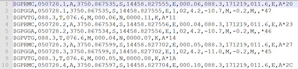

NMEA 0183 is the data specification standard that AppStudio uses to communicate with GNSS receivers. NMEA messages contain lines of data called sentences. To cut a long story short, save these sentences to a file, and you can replay them in an AppStudio app just like when they are coming directly from a satellite system. The contents of the file will look something like this:
