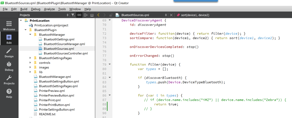

  • This sample specifically filters for only devices that have ‘iMZ’ or ‘Zebra’ in their name. If you are experimenting with a different printer, remove (or comment out) lines 87 and 89 (leaving line 88) from /BluetoothPlugin/BluetoothManager/BluetoothSources.qml.
When you do this, you will see that all paired Bluetooth devices will appear in the list. There isn’t a standard device type that can be used to filter for only printers, so once you get your app working with your printer, think of a good name filter to use to hide the noise of all possible pair devices.
