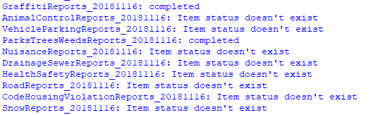

In order to do that, I've put together the following script. The problem is, though, I can't get a status on some of the geodatabases.

Here is an example of the messages I get:
Any thoughts or comments on this would be much appreciated. Thanks!
