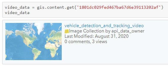

Based on the output seen in the sample notebook (https://developers.arcgis.com/python/sample-notebooks/vehicle-detection-and-tracking/) I am inferring access might be needed to the vehicle_detection_and_tracking_video image collection owned by api_data_owner
I was unable to locate the above-mentioned image collection when searching in ArcGIS Online and when the item is clicked it opens to a sign-in page for the ArcGIS Online subscription

You are getting this error because the following video has not be shared publicly:

Hello,
The data has been shared. Please have a look now, you should be able to access it now.
