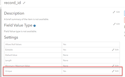

JakeSkinner
Esri Esteemed Contributor
@LienPham1 have you tried executing ArcGIS Pro's Append tool?  This provides an upsert option which will update existing features with new data and add new features.  To use the upsert option, make sure the field your using in the hosted feature service has a unique index:
