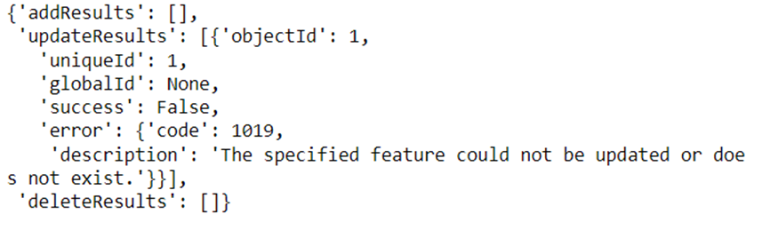

Here's the error message:
EarlMedina
Any chance that layer has globalids? If so, you try to set the  "use_global_ids" parameter of edit_features to True.  Only other thought is maybe there's a problem with the auth.
michael_vetter
No the layer doesn't have globalids
