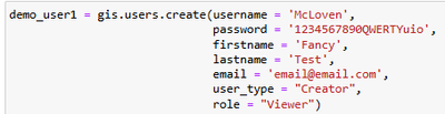

AFackler_NAPSG
For friends who come across this later and grit your teeth on why this won't work, I found that my organization only allowed the user type "Creator" with a custom role. When the user type and role were modified to be exactly what the org required, it worked like a charm.
