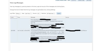

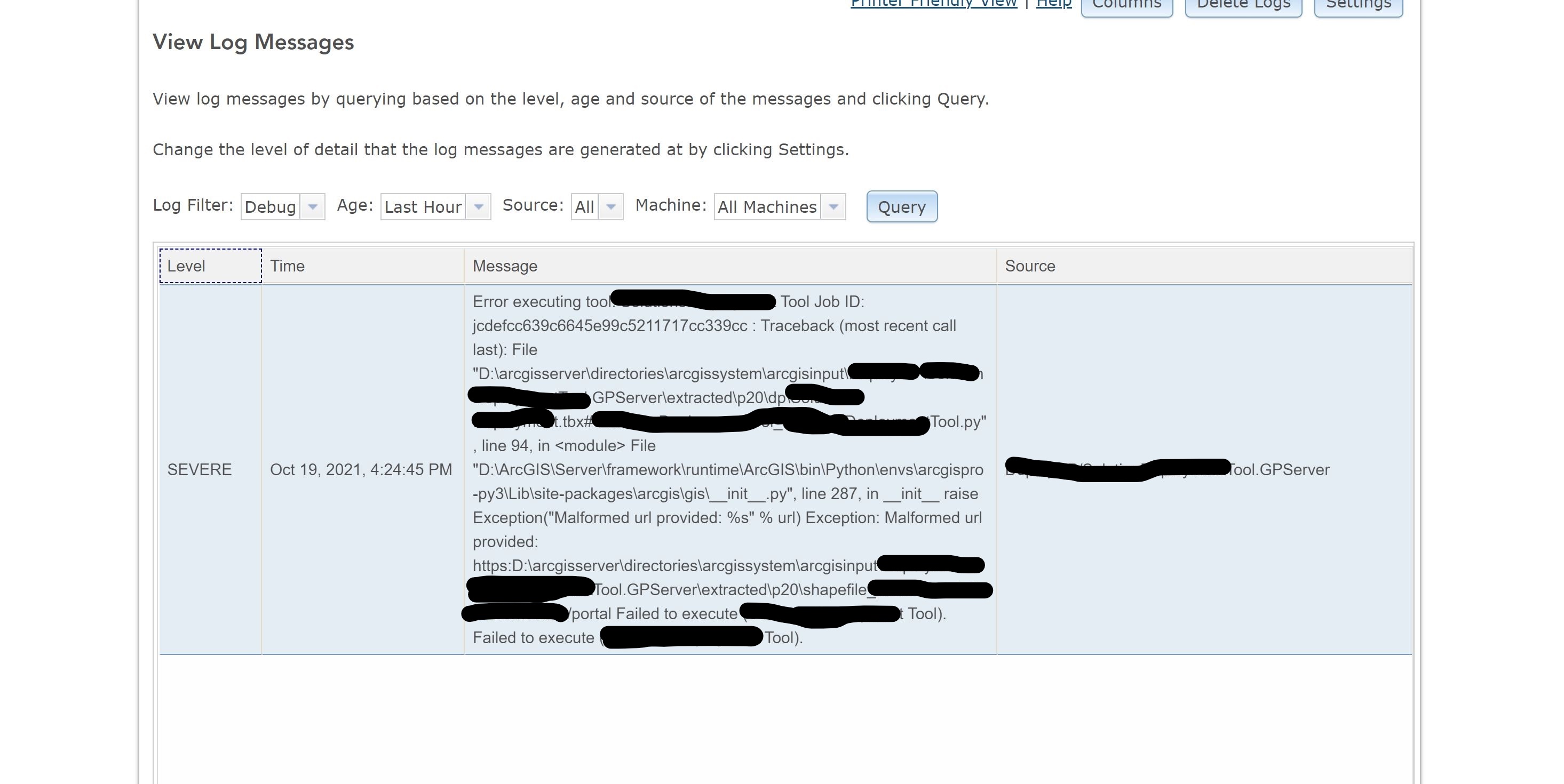

I am unable to use the GP service that I have published and I get the below error. I have tried
  1. Registering my data source with the server (though all the input parameters are strings)
  2. Cloning a separate environment with all the required packages to run this particular tool
Please advise, thanks!
MariamJamilah
Issue resolved.
Issue Identified: I was unable to make a connection to my ArcGIS Portal using the GIS object from ArcGIS Python API.
Solution: Refer to this link: https://support.esri.com/en/technical-article/000022882
