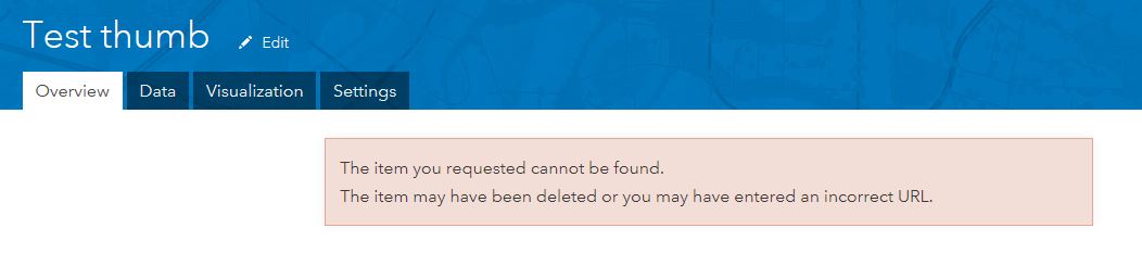

However if I use the Python API to add the same URL into a different content item then a thumbnail is not generated. When I go to the content item in Portal it shows an error at the top of the page - see image below:
Error seen when trying to display a thumbnail for an item that has been added via the Python API
This disappears if I click anywhere near it but returns again if I refresh the page.  If I manually edit the thumbnail and upload an image from my PC then I don't see the error again.

You can request the server to create a thumbnail using the export_map method. Once you have a thumbnail, either through export_map or a file on local disk, you can specify that in the 'thumbnail' argument of the 'add' method. Refer to this api reference: arcgis.gis.ContentManager.add
Alternately, you can update an existing item and specify the thumbnail. Refer to this example: managing your content | ArcGIS for Developers

Thanks Atma. I think your second link to the API reference is probably the same as I put at the bottom of my original question.  My comment about not having a useful worked example on that page is I think still valid but thankfully the managing your content example has useful guidance on how to specify a path on my local PC for the thumbnail.
