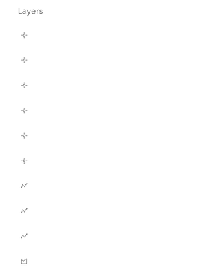

In the created view, there are ten layers - five are missing:

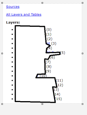

But it gets better. In the view url source, all layers 15 layers are listed:
