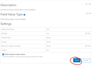

Can you set a field as unique using the arcgis rest api for python?

You can, enabling unique values means adding an index with a unique constraint to the field.  To do this in the API you'll want to call the FeatureLayerManager's add_to_definition() function, passing in something like this:
{"indexes":[
  {"fields":"MyField",
   "isUnique":True,
   "description":"For uniqueness"}

thanks that works - this is the code:
layer = published_item.layers[0]
layer.manager.add_to_definition({
    "indexes": [
            "fields": "some_id",
            "isUnique": True,
            "description": "For uniqueness"
