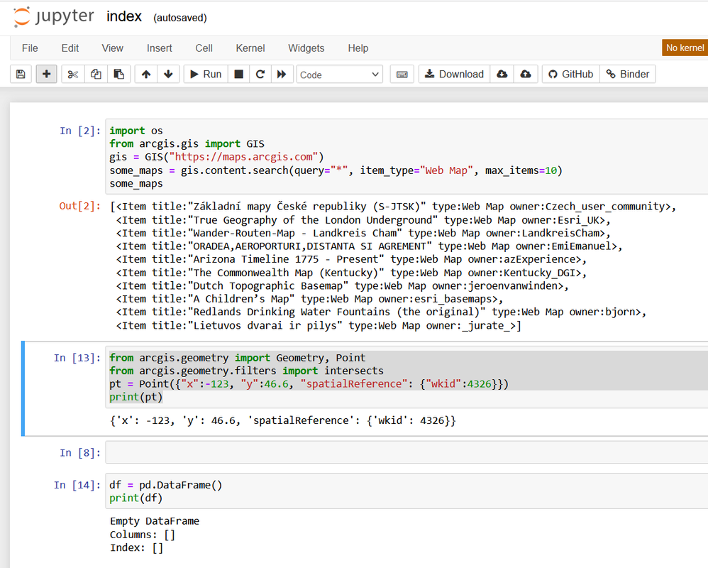

Searching for ways to host Python online for free (or cheap), I found Binder.
Binder is not exactly what you're asking for but very cool. They let you upload and run notebooks, apparently 100% for free. It looks like it is a project of the Leibniz Institute for Social Sciences.
To load my test project, I set up a simple project and then saved it to a git repository and then fed the URL to mybinder.org
My code is at https://github.com/brian32768/hello-binder
You can try running it here https://mybinder.org/v2/gh/brian32768/hello-binder/main?labpath=index.ipynb
I set it up in Visual Studio Code and it will show me the map there, sadly it does not show up in Binder. But you asked if you could run geometry operations so I added a cell for that. Yes, it worked.
from arcgis.geometry import Geometry, Point
from arcgis.geometry.filters import intersects
pt = Point({"x":-123, "y":46.6, "spatialReference": {"wkid":4326}})
print(pt)
Brian_Wilson
Honored Contributor
screenshot from Binderscreenshot from Binder
