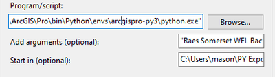

@Clubdebambos  Appreciate the response! My trigger is just weekly on fridays when my user is signed in. Here is my action:
I'm new to python but I'm lost as to why the entire script works up to the part where I want to move the file.
Any further advice is greatly appreciated!!
