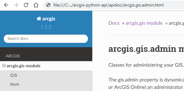

Thanks, I did know about that, but as far as I am aware you cannot view api doc like in https://esri.github.io/arcgis-python-api/apidoc/html in that original git hub view.
I was hoping to avoid downloading it but its not actually that hard, obviously have git (or something related) first, then in command prompt:
C:...\> git clone https://github.com/Esri/arcgis-python-api.git
Cloning into 'arcgis-python-api'...
Receiving objects: 100% (10577/10577), 837.94 MiB | 3.49 MiB/s, done.
Checking out files: 100% (600/600), done.
Now browse to:
file:///C:.../arcgis-python-api/apidoc/index.html
As at writing online is 1.6.2 but default is still 1.6.1.
Then to change to a different version:
C:...\> cd arcgis-python-api
C:...\arcgis-python-api> git tag -l
v.1.4.2
v1.4.1
v1.5.0
v1.5.1
v1.5.2
v1.5.3
v1.6.0
v1.6.1
v1.6.2
v1.6.2-post1
v1.6.2-post2
v1.6.2-post3
C:...\arcgis-python-api> git checkout tags/v1.5.3
Checking out files: 100% (1186/1186), done.
Note: checking out 'tags/v1.5.3'.
HEAD is now at 2b2d324 Adding v1.5.3 API doc so we can tag v1.5.3 samples and guides
Browse again/refresh to:
To compare side by side, copy the git repo folder, change directory to it, change/git checkout the tag you want, and browse to that folder's new local ...apidoc/index.html.
