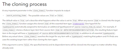

I wonder whether the layers within your new feature service may be empty because clone_items() detects that they have already been cloned previously within your portal?
This section of the documentation describes this - https://developers.arcgis.com/python/guide/cloning-content/#the-cloning-process
To workaround this you could set the parameter search_existing_items=False within clone_items()
