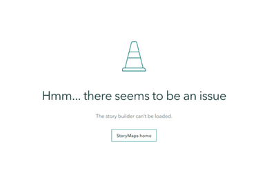

Hi,I have some question about creating story map from coding using python.
This is my code
from arcgis.gis import GIS
portal_url = "https://your-organization/portal"
gis = GIS(url=portal_url, username="YourName", password="YourPassword")
storymap_item = gis.content.add({"type": "StoryMap",'title': 'My Test Python Story2'
                                } , owner = "YourName")
storymap_item.share(everyone=False)
storymap_url = storymap_item.homepage
print(f"StoryMap URL: {storymap_url}")
It's create story map in my content but it can't be view or edit like create with normal way
Does anyone has solution for creating Story map from python or have docs for help?
Appreciate all answers, btw sorry for my bad english.

Hey @Tbones
Is there any difference if you change the sharing level to everyone or org?
storymap_item.share(everyone=True, org=True)
Cody
Tbones
Thank you for the answer. I already fix it by using arcgis.apps.storymap import StoryMap.
