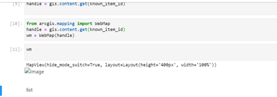

I have a fresh install of ArcGIS Pro and am trying to use jupyter-lab to work through the exercises. As others have discovered, when I try to display a map it generates a broken link:
 I've worked through everything in this thread - ArcGIS Pro is updated, conda updated everything, etc. No dice.

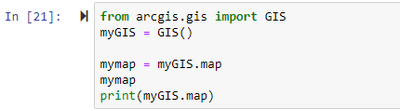

I'm having a similar issue.
I have two cells running the exact same code.
and:
The first block of code returns an error I've never seen before and can't find online:

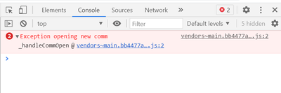

The second block returns a map box with no map and this error:
Looking in the console it appears to be this error that is causing the issue.
Is anyone familiar with this error and knows how to fix this?

I also saw that the myGIS.map in the first block didn't have the () behind them.
This did solve the bound method error, but sadly not the second error.
